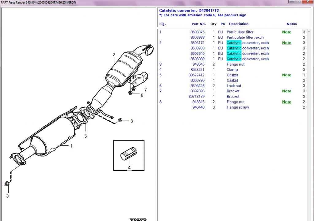

Posted 7 Dec 2010 · Report post Se pare ca nu exista, acum m-am uitat in vadis. Share this post Link to post Share on other sites
Posted 7 Dec 2010 · Report post La ce motor nu exista? Share this post Link to post Share on other sites
Posted 7 Dec 2010 · Report post Strange Cand ii fac schimbul ma uit si la a mea,parca il vazusem...ce-i drept e E3 Share this post Link to post Share on other sites
Posted 7 Dec 2010 · Report post Mie imi arata catalizatorul legat direct de turbo, ma rog printr-o flansa. Share this post Link to post Share on other sites
Posted 7 Dec 2010 · Report post Mie imi arata catalizatorul legat direct de turbo, ma rog printr-o flansa. E vorba de 1.6d... Share this post Link to post Share on other sites
Posted 7 Dec 2010 · Report post Asta e 1.6, dar nu am vazut nici un racord:( Share this post Link to post Share on other sites

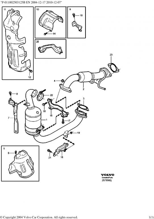

Posted 7 Dec 2010 · Report post Inseamna ca ori e ceva slabit, ori a aparut vreo micro-fisura pe undeva. Intr-o poza mai sus(pusa de mine) pe la um injector imi scapa putina motorina. Imi poti spune daca are vreo granitura/ceva? Share this post Link to post Share on other sites
Posted 7 Dec 2010 · Report post Screen.pdf Pozitia 2b pare a fi o saiba, probabil de cupru. Share this post Link to post Share on other sites
