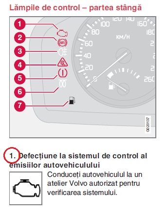

Posted 22 Jun 2012 · Report post Salutare, De fix 900 de km de cand i-am facut revizia cu schimb de ulei + filtre am observat, si eu si alti pasageri, ca dupa un anumit timp de la pornirea motorului, in habitaclu incepe si miroase puternic a gaze arse de esapament. Daca am dat drumul la AC atunci mirosul dispare, insa nu in totalitate. Cu cheia la punctul ||, motorul nepornit, am martorul "Defectiune la sistemul de control al emisiilor autovehiculului" aprins. Dupa pornirea motorului, acesta se stinge. Vezi poza. Ce problema ar putea fi? Toate bune! Share this post Link to post Share on other sites

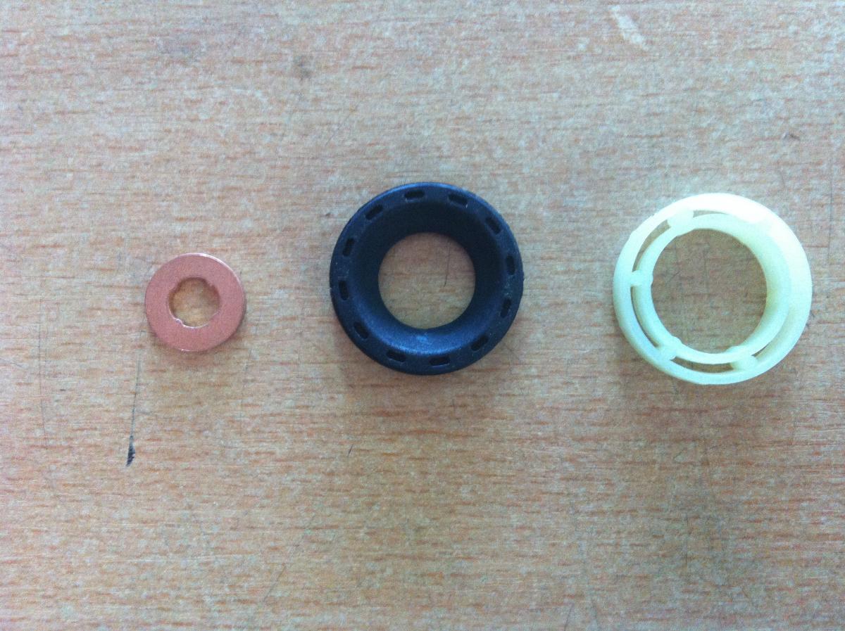

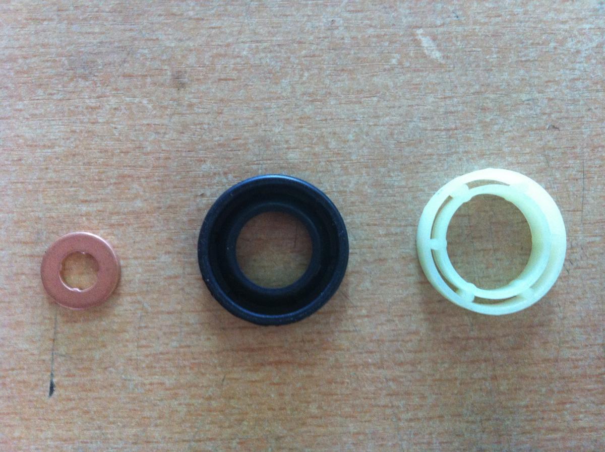

Posted 30 Jun 2012 (edited) · Report post Am luat si eu astazi de la Neste Automotive Chitila la 58 RON setul si arata cam asa: Multam ptr indrumari lui @Dinoco Edited 30 Jun 2012 by birkof 1 person likes this Share this post Link to post Share on other sites
Posted 16 Jul 2012 (edited) · Report post Desi s-a rezolvat problema, Birkof spune ca raman aprinse pana porneste motorul martorul de " Malfunction indicator light" si "Oil pressure warning light" Chestie .....: din user manual: 1. Malfunction indicator light As you drive, a computer called On-Board Diagnostics II (OBDII) monitors your car's engine, transmission, electrical and emission systems. The CHECK ENGINE light will light up if the computer senses a condition that potentially may need correcting. When this happens, please have your car checked by a trained and qualified Volvo service technician as soon as possible. Si cea cu presiunea la ulei, : 4. Oil pressure warning light If the light comes on while driving, the car, stop the engine immediately, and check the engine oil level. If the oil level is normal and the light stays on after restart, have the car towed to the nearest trained and qualified Volvo service technician. After hard driving, the light may come on occasionally when the engine is idling. This is normal, provided it goes off when the engine speed is increased. Aici e mai clar: "If the light comes on while driving," deci nu e normal sa ramana aprinse pana porneste motorul, si sa fie problema daca nu se sting, sau daca apar in timp ce te deplasezi? Rog toti posesorii de s40 sa se uite la martori Edited 16 Jul 2012 by gordon Share this post Link to post Share on other sites
