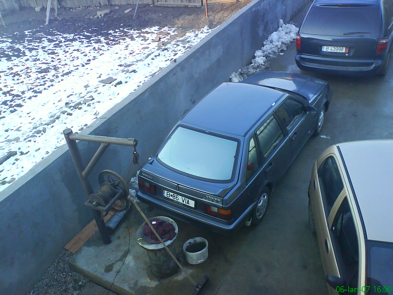

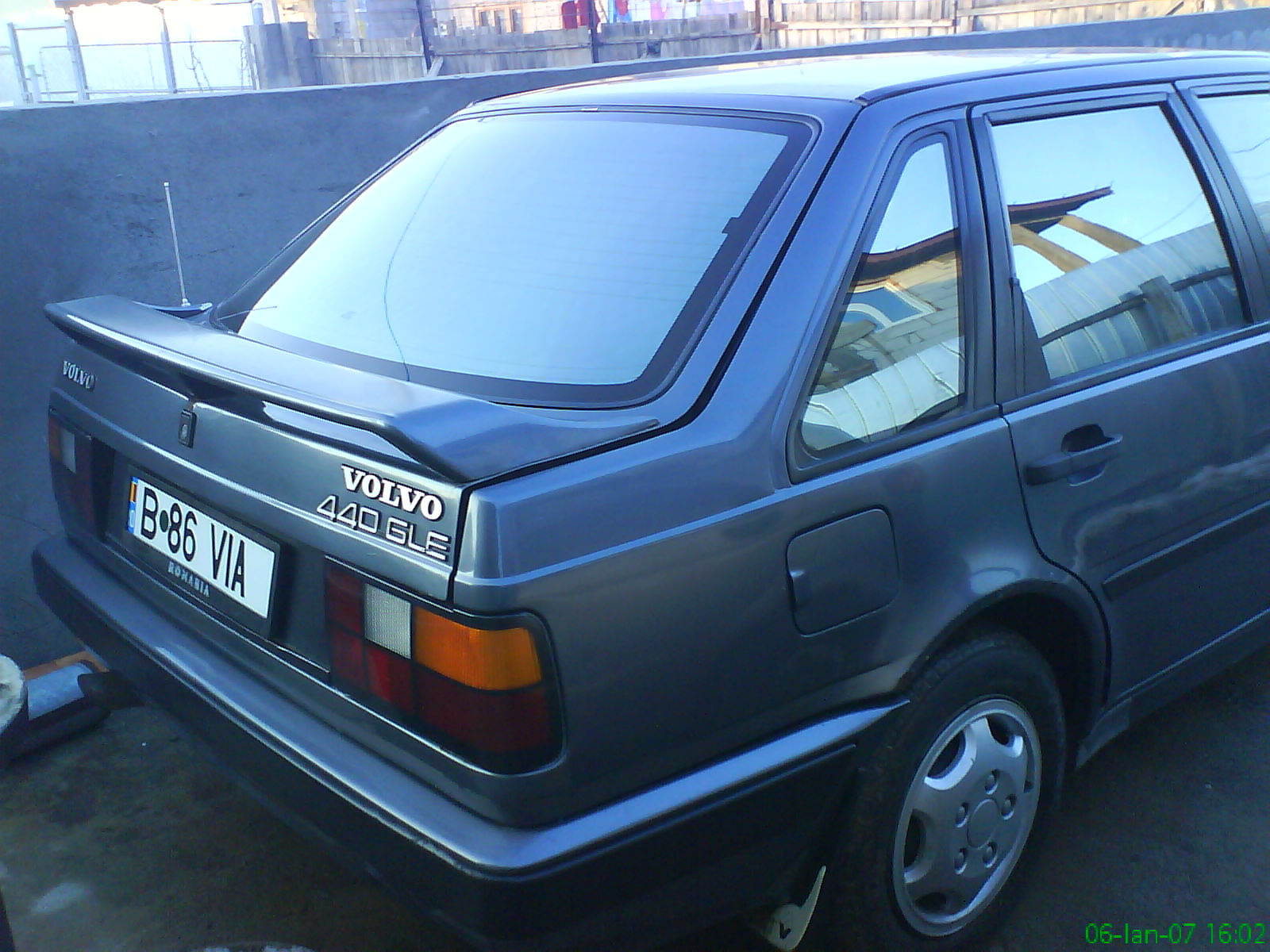

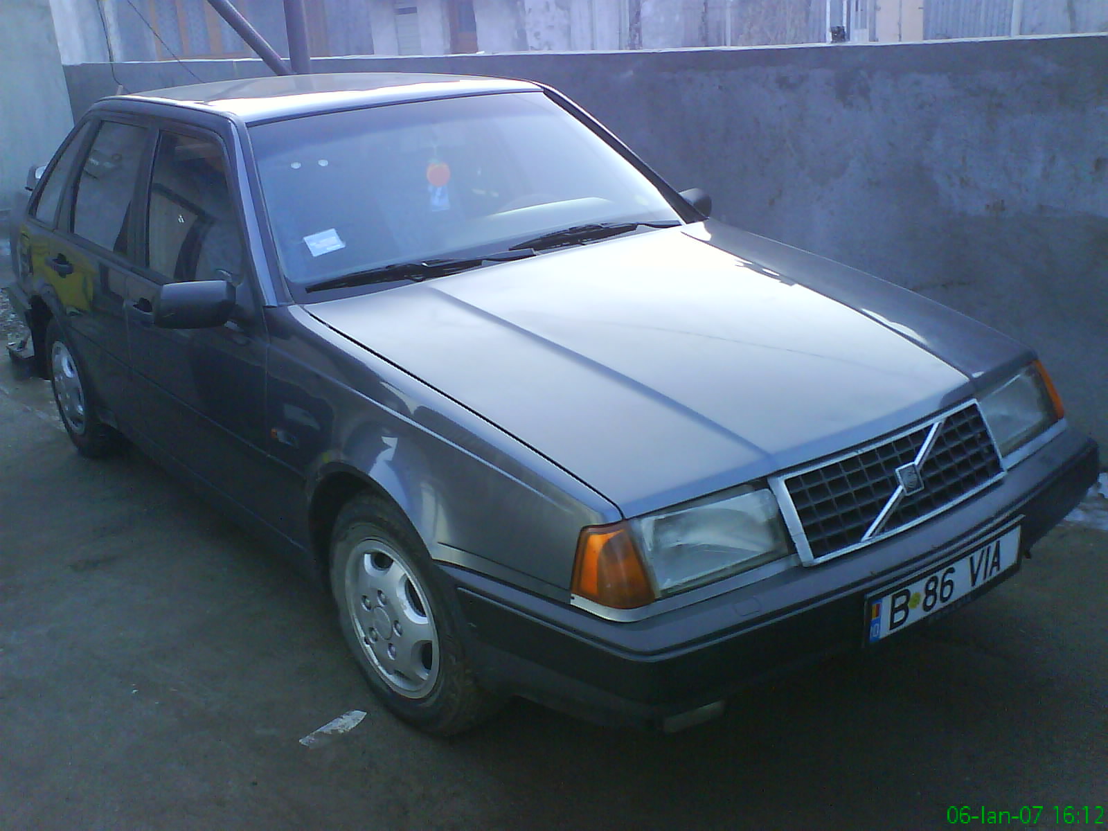

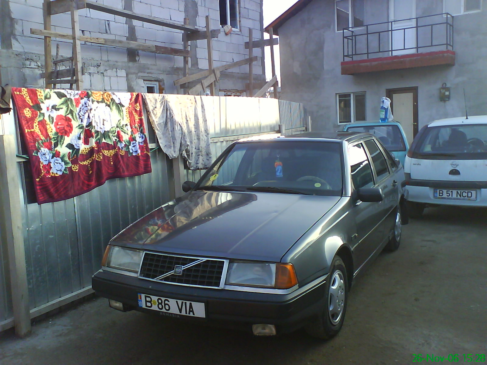

Posted 7 Jan 2007 · Report post am urcat cateva poze cu masina mea....sper sa va placa Share this post Link to post Share on other sites
