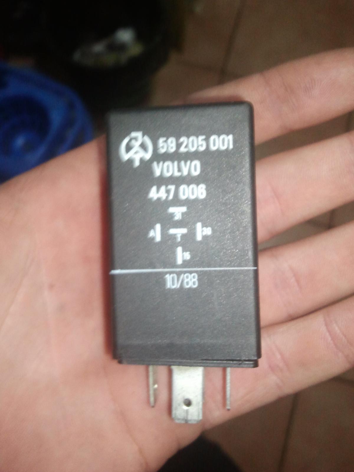

Buna seara, as dori sa intreb si eu ce face si ce rol are acest releu pentru ca nu il gasesc absolut nicaieri si din cauza aceasta presupun ca nu mai imi porneste masina sub nici o forma.
1. Acest releu l-am gasit in partea din stanga a volanului cand am desfacut capacele si am inceput sa caut dupa relee defecte.
2. Din cauza acestui releu presupun ca imi "zapacea" relantiul inainte, ca altfel nu imi pot explica
Daca stie cineva ce este si ce face va rog ajutati-ma !

Astia pe afara zic "Wehrle 59205001, Electrical water pump (EP/FP, red:3,16)or(FT, yellow:3,22)"
si "Wehrle 20 210006, Ignition relay contact 15 (3,03)"
Vezi daca mai este vre-un releu cu codul asta si verifica-l
1. Hella Lampcontrol 12V, Class 3, 448130, 5KG005918-01, Running lamp 2x21W
2. ABS Pump-relay
3. foglights (white for the Netherlands (3,08 Silver), for Europe (3,12)
4. 412653 12V/20A, Popup-lights
5. Wehrle 59205001, Electrical water pump (EP/FP, red:3,16)or(FT, yellow:3,22)
6. ABS pump, electrical relay mark 2 (3,09 red)
7. Empty, (antifogs rear (NEDERLAND 3,07)
8. Air conditioning for european cars (3,05), earlier antifogs for the Netherlands(3,12)
9. Pop-Up relay, 5DS0050053-00
10. Wehrle 20 210006, Ignition relay contact 15 (3,03)
11. Wehrle 20 210006, Fusebox relay contact 75 (3,04))
12. Contact for diagnosis ABS mark 2
