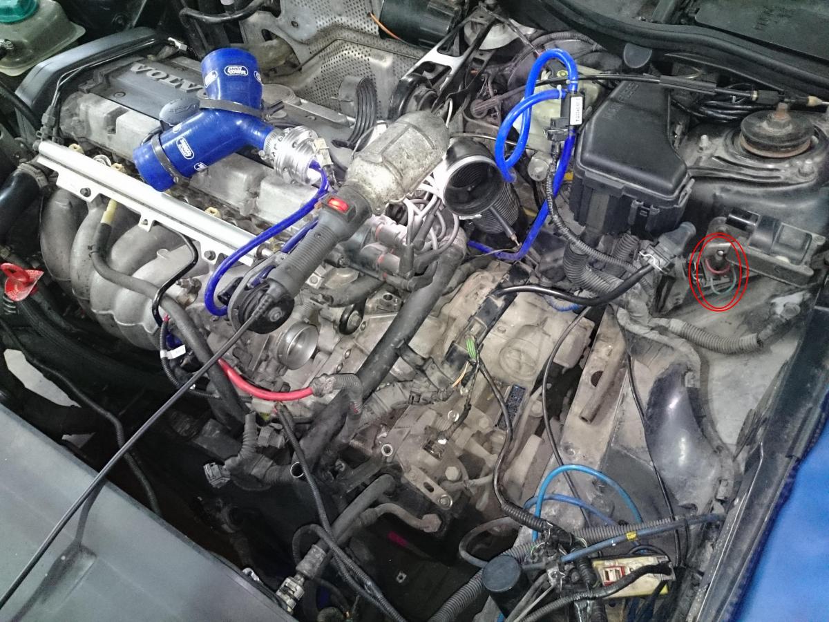

Posted 9 Dec 2014 · Report post Arunca un ochi la stage-ul de aprindere, e o cutiuta mica inainte de bobina. IDM cred ca-i zice. Share this post Link to post Share on other sites
Posted 9 Dec 2014 · Report post Nu stiu la ce te piesa te referi. Share this post Link to post Share on other sites
Posted 9 Dec 2014 · Report post Uite aici cu 2 cercuri rosii .. din poza cu motorul lui Alex. Share this post Link to post Share on other sites
Posted 9 Dec 2014 · Report post E vorba de modulul de comanda al bobinei de inductie. Share this post Link to post Share on other sites
Posted 9 Dec 2014 · Report post Ok,dar ce pot verifica la aceasta piesa? Share this post Link to post Share on other sites
Posted 9 Dec 2014 · Report post E vorba de modulul de comanda al bobinei de inductie. primarul ,dar mai evoluat.,cica lucreaza si in tensiune si frecventa. Share this post Link to post Share on other sites
