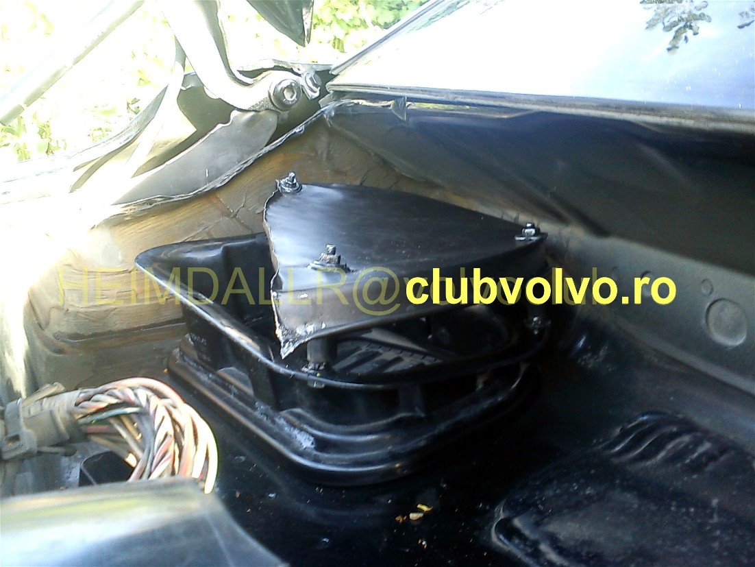

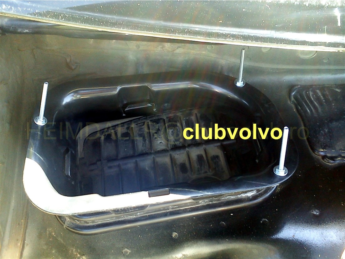

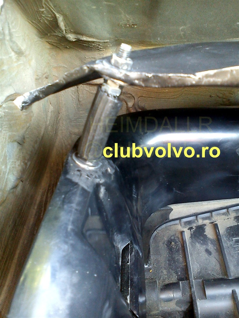

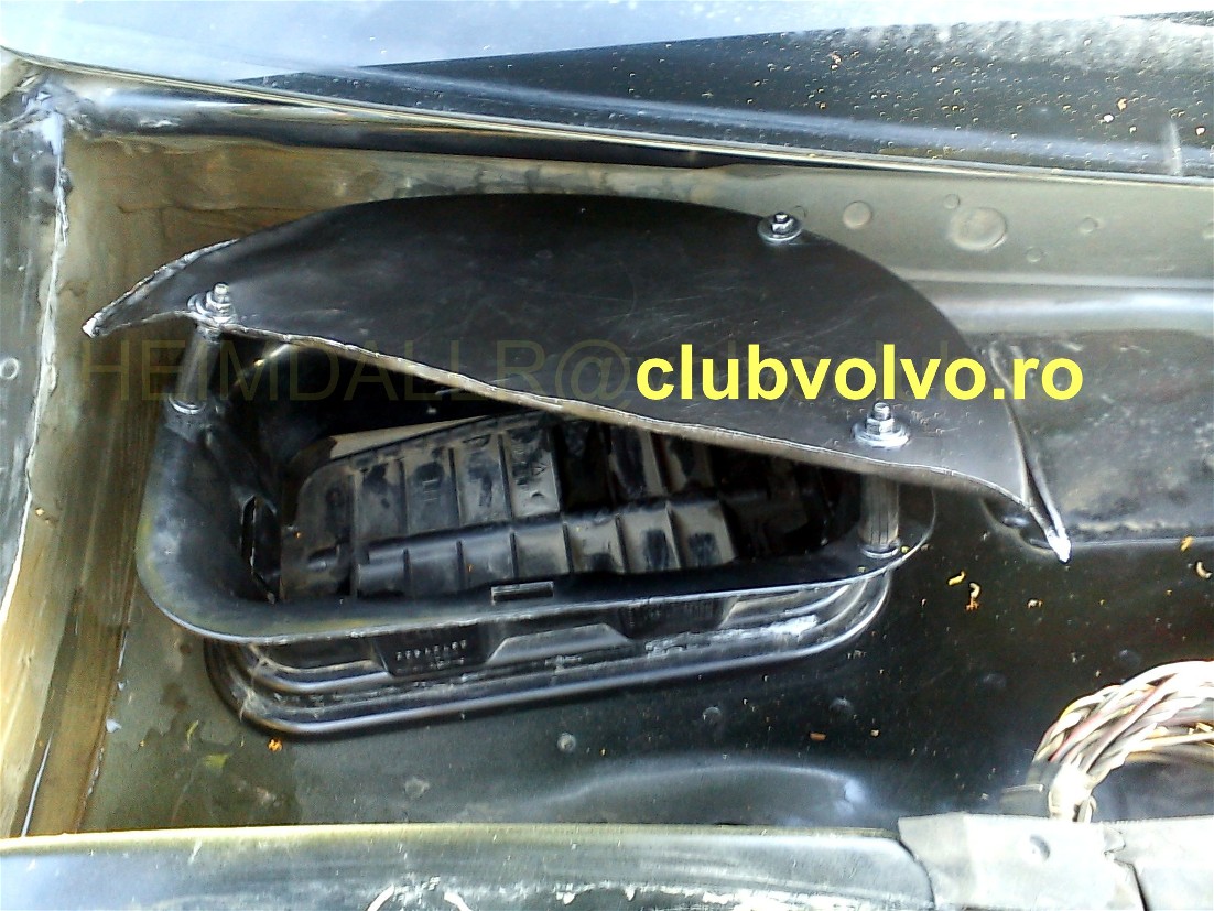

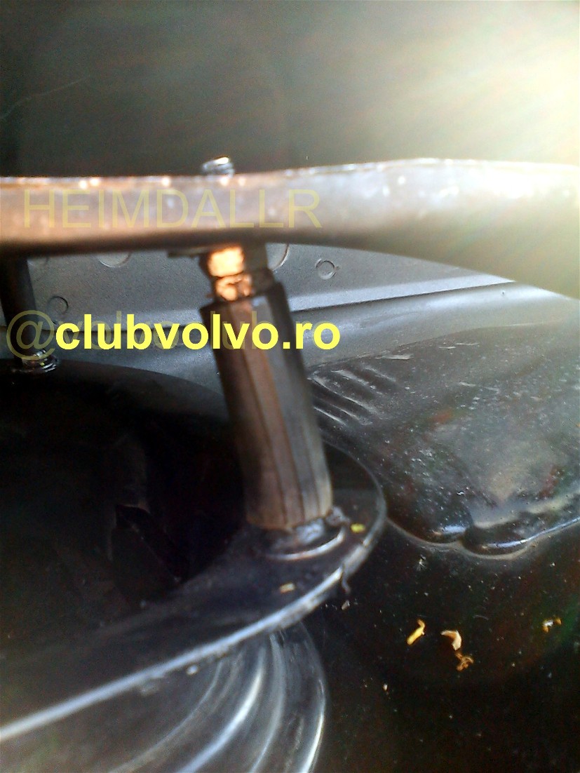

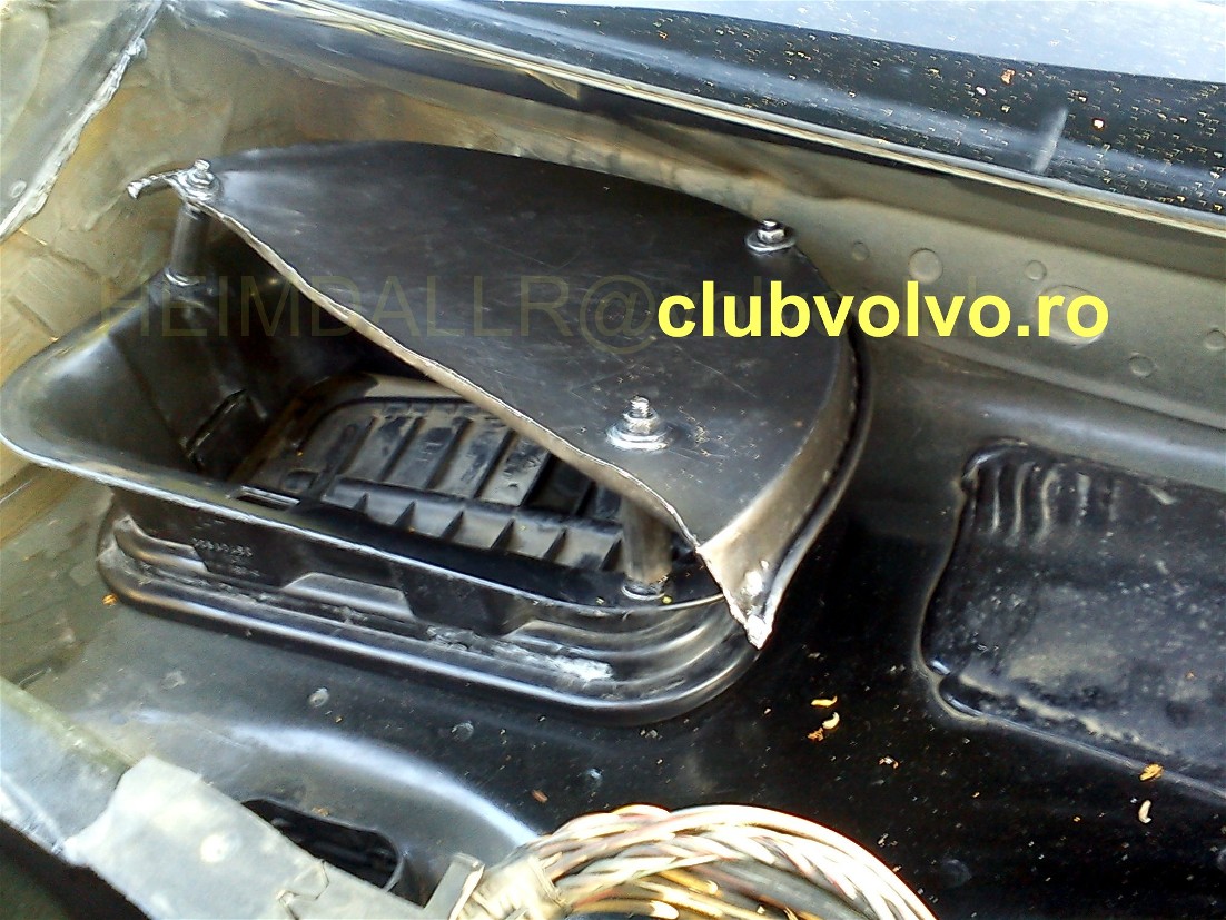

How to install drip protection over the climate air inlet housing in P2-platform Volvos
