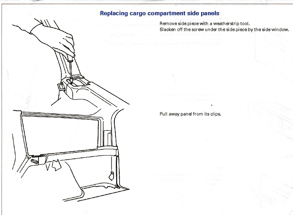

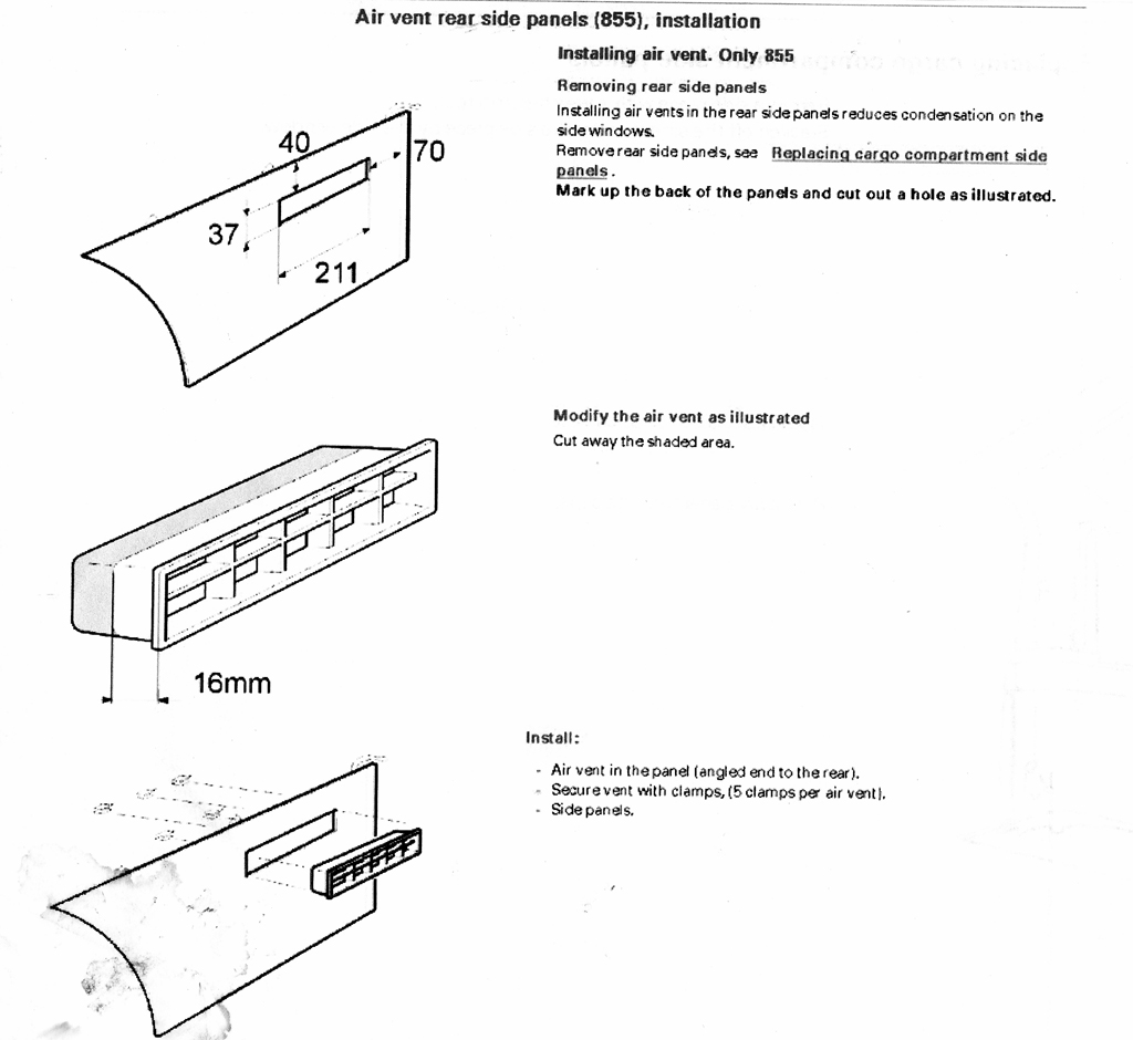

Si conform celor care au construit 850-ul estate:"Sixteen vents control the airflow around the interior including two on the rear
side windows of the luggage compartment to aid excellent all-round visibility." Plecind de la aceasta idee - cele 2 fante de ventilatie ale geamurilor laterale Cargo - ia uite ce am gasit si eu, un update pentru a modifica gurile de aer de la cargo - "to reduce condensation on the side windows".
  He he he  ;)  Poate va mai fi de folos pentru cineva, cine stie ?  Maine ma apuc de treaba.
