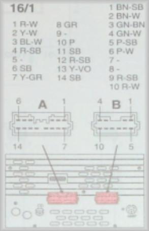

A4 & A12 = + PLUS
A6 & A14 = - MINUS
    MODEL            Manufacture        M C U             EEPROM
VOLVO SC-816    MITSUBISHI     D75517GF 409      24C01
