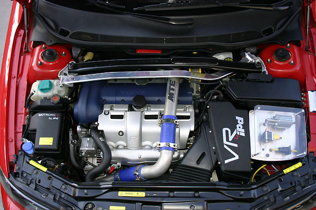

Posted 8 May 2009 · Report post "The main function of these systems is to suppress detonation caused by high temperature and pressure developed within the combustion chamber when the effective compression ratio has been taken beyond the auto-ignition point by a turbo (high boost). Water, with its high latent heat content, is extremely effective for controlling not only the onset of detonation but also the production of oxides of nitrogen in modern leanburn engines like Volvos." Share this post Link to post Share on other sites
Posted 8 May 2009 · Report post te ajuta sa dai scinteia mai tirziu la compresie mai mare.in plus, ajuta arderea (in cantitati optimizate)la benzina are un rol de anti - autodetonatie. Share this post Link to post Share on other sites
Posted 9 May 2009 · Report post in plus, scade semnificativ temperatura in admisie .... Share this post Link to post Share on other sites
Posted 10 May 2009 · Report post Intrebare pentru cunoscatori: de ce nu trebuie sa iti intre apa in admisie dar particulele de la Water injection fac bine in admisie (racind temperatura) ? Share this post Link to post Share on other sites
Posted 10 May 2009 · Report post In linii foarte mari:NU trebuie sa iti intre apa in admisie in cantitati mari. Apa poate cauza fenomenul de hydrolock (google it! ) datorita incompresibilitatii ei (ai apa multa in cilindri, pistonul nu mai poate compresa amestecul, rezulta biele indoite, etc). Cateva picaturi, transformate in vapori, nu fac rau. Important este sa nu bagi prea multa .Oricum, nu se baga doar apa, sau cel putin eu nu bag (amestec cam 60% etanol/metanol+apa), de aici rezulta o cantitate foarte mica de apa care ajunge efectiv in cilindri.Cine are bani si resurse, poate merge cu metanol 100%, crescand cifra octanica, imbunatatind arderea, bla, bla, etc Ideea de final e ca nu e rau daca bagi doar putina apa, dar sa nu sari calu' .... Share this post Link to post Share on other sites
