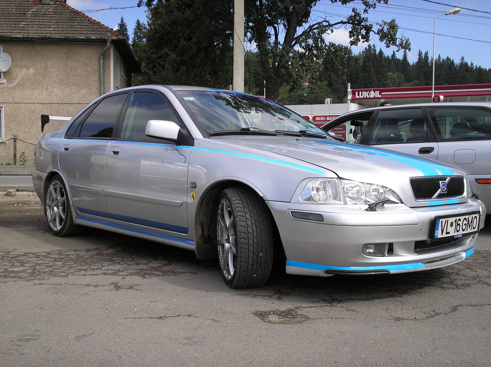

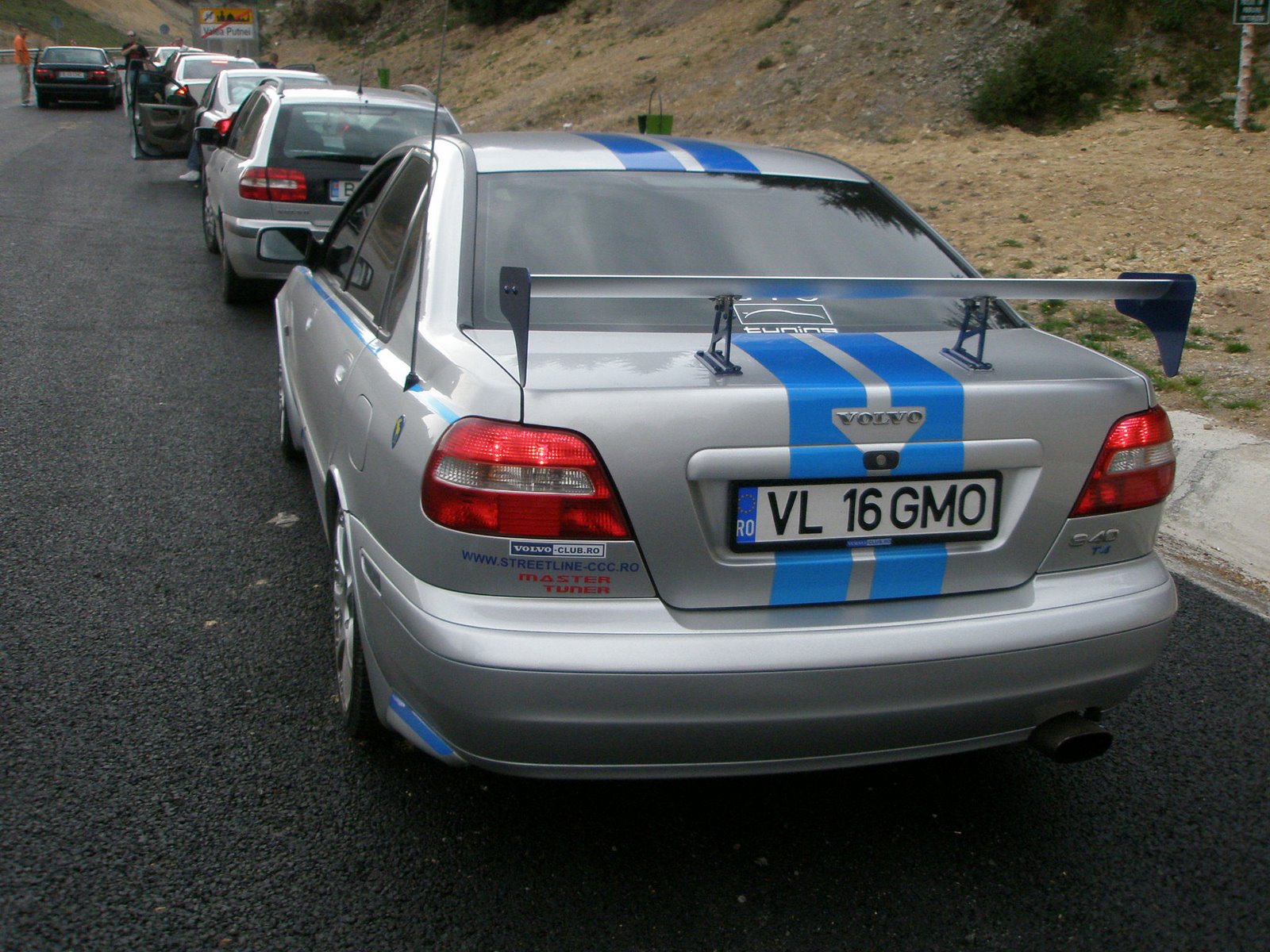

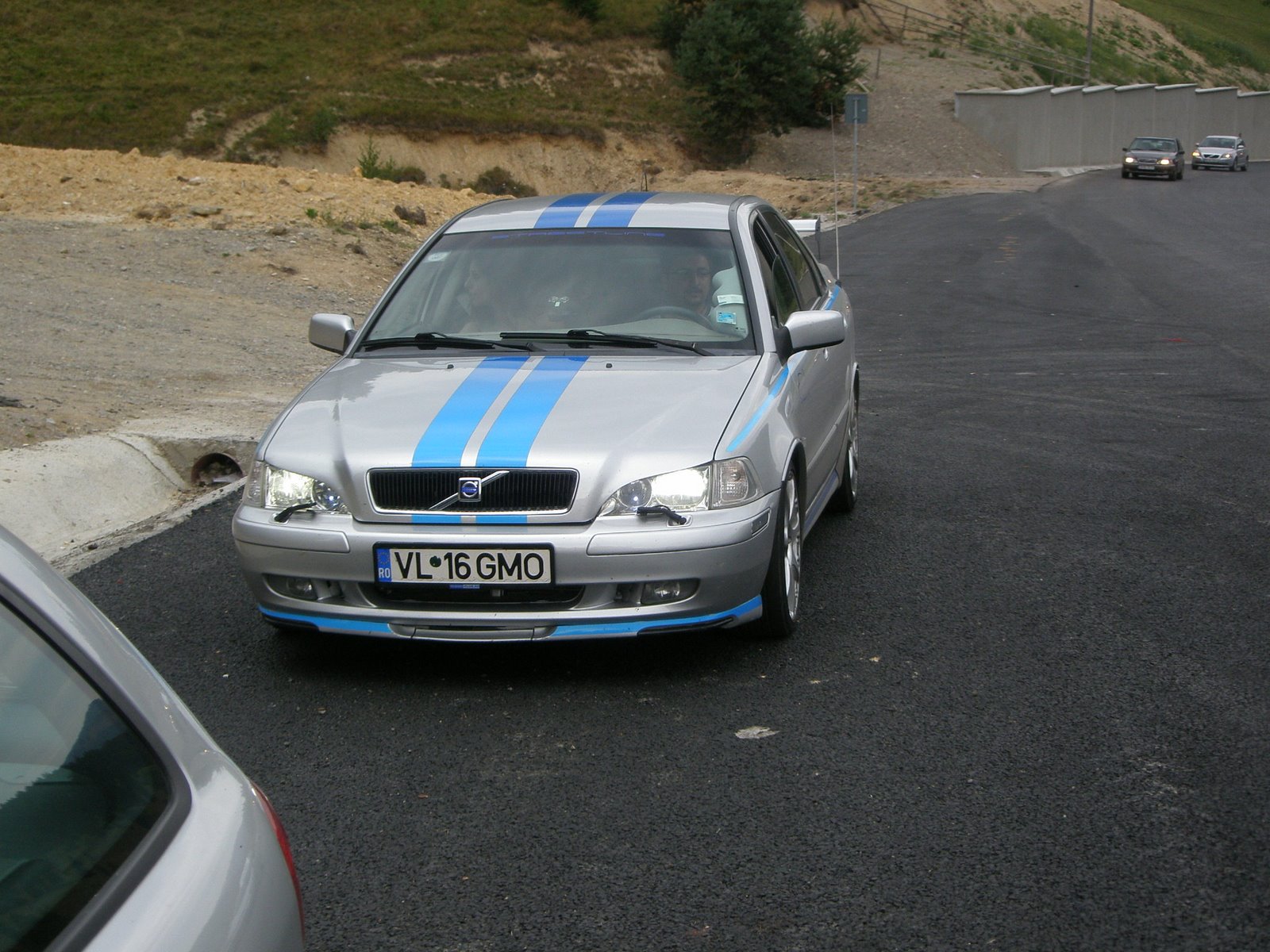

Se da una buncata Volvo S40 T4 Phase 2, cu (aproximativ) urmatoarele modificari:
Exterior:
OEM Volvo Front Lip Spoiler
OEM Volvo S40 Phase 1 rear side skirts
Custom Hood (over the headlights)
Custom headlights wipers (smaller)
Black painted front grill
Body-colour painted exterior trims, lip spoiler, skirts
European Tuning Smoked Side Marker Lamps
Simoni Racing Fast Wing
Llumar tinted windows
Blue-painted brake calipers
Devino Voracity 17" Rims
Custom Blue Vinyls
LED position lights, side lamps and rear number plate
Dietz undercar remote-controlled lights (multicolor, set to blue)
Interior:
Aluminium dial rings
Silver Dashboard Trim set
Raid-HP left pillar gauges (Boost, Oil Temperature, Air-Fuel Ratio)
Interior floor and rear blue lights
LED courtesy lights
4 JBL Speakers + Magnat Woofer + Autotek Amplifier
Magic Button (details later  ;) )

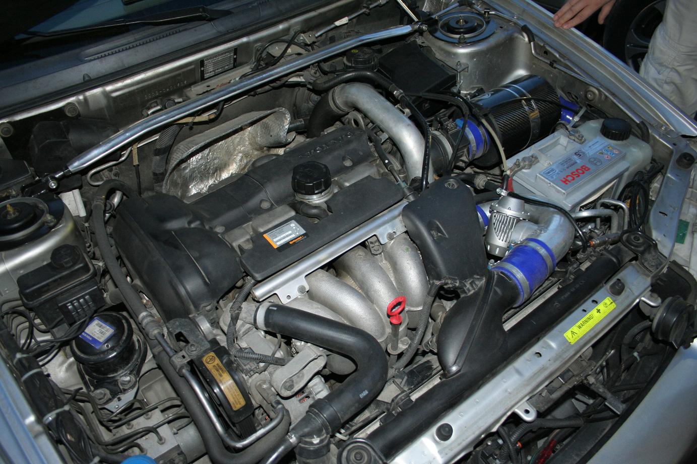

Technical:
RBN ECU remap
Unichip by Master Tuner with 3 selectable maps via the Magic Button: low-pressure map (1.2 bar), high-pressure map (1.4 bar), race-map (1.4 bar + AIS)
AIS Stage 1 Water-Methanol Injection Kit
BMC Carbon Dynamic Airbox Induction Kit
Aluminium Intercooler to Throttle Body pipe
HKS SSQV blow-off valve
NGK Iridium Spark Plugs
Turbo-back custom exhaust: 3" downpipe, Magnaflow race-cat, 2.5" catback (2 Borla resonators, AK Performance muffler)
EBC Brakes (Turbo-Groove discs, YellowStuff race-pads)
Koni Sport lowered suspension kit
Mitsubishi Evo 4 front strut brace
Mitsubishi Evo 4 polyurethane engine mounts
Mitsubishi Evo 3 rear strut brace
Mitsubishi Evo 3 rear polyurethane bushing

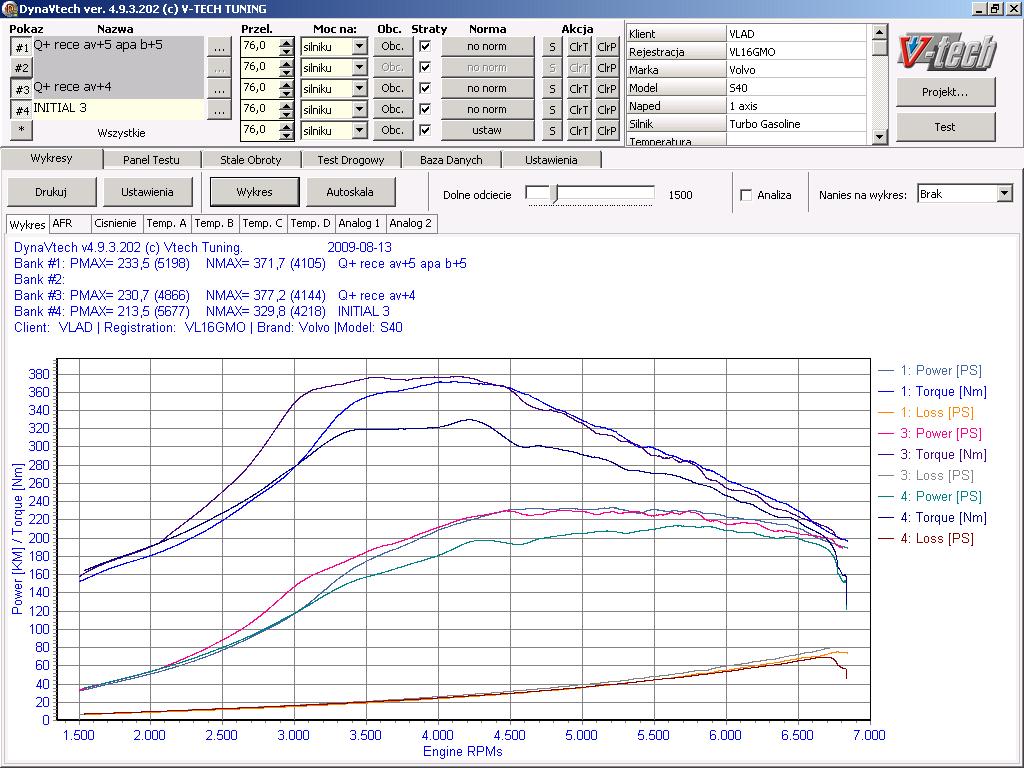

Cu aceste modificari masina scoate aprox 230cp si 370NM pe dyno la o temperatura de 35 grade Celsius. Pe strada, ar insemna vreo 240-245cp.
Atasez si cateva poze, atat cu masina stock cat si cu ea modificata, precum si cu fisa dyno.
Toate cele bune,
Vlad

- Toba finala este AK Performance USA, dar este irelevant daca este sau nu pentru S40 tinand cont ca am toata evacuarea facuta custom, incepand de la turbina (downpipe pe 76, restu pe 63)
- blow-off-ul este universal
- 205/40/17 (ar fi mers 215/40/17, dar tinand cont ca jantele au ET35 in loc de 40-42 cat ar fi trebuit imi ating cu 215 - e f.f.f. greu sa gasesti jante cu 4x114.3)
- Da, bucsile de evo sunt direct-fit!
- cu torque steeru stau destul de bine, chiar nu e deranjant. ajuta suspensiile si cauciucurile inguste.
pe partea de performanta, nimic de comentat. cu toate ca ma asteptam la mai multi cai dupa ce ai facut, si la presiune de 1,4.  dar daca atat se poate.....sunt destui si 240.

-jante + suspensie nota 9 ( 10 ar fi fist sa ai cauciucurile de 215 , ca are nevoie de aderenta, si la 165 de cai imi scartaia rau cu 205 )
-viniluri : cele centrale sa zicem ca sunt acceptabile, dar alea laterale mi se par din alt film decat masina.

m-ar ajuta alt intercooler, probabil ca de acolo si vine lipsa de putere. Cat priveste turatia ... ai fisa dyno ... look it up :)
aha :) acum m-am uitat la fisa.  foarte misto faptul ca intre 4000 si 6500 sta peste 200 de cai. sa pui si tu un filmulet daca ai cu 100-200, sau ceva de genul, nu de pe loc. ca sa fac si eu comparatie cu fosta mea masina. :)
