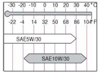

Operation in hot climates
When temperatures exceed 86°F (30°C) in your area, Volvo recommends, for the protection of your
engine, that you use a heavier weight oil, such as SAE 10W/30. See the viscosity chart below.
Oil viscosity (stable ambient temperatures)
Operation in temperate climates
Incorrect viscosity oil can shorten engine life. Under normal use when temperatures do not exceed 86° F
(30° C), SAE 5W/30 will provide good fuel economy and engine protection. See the viscosity chart
above.
