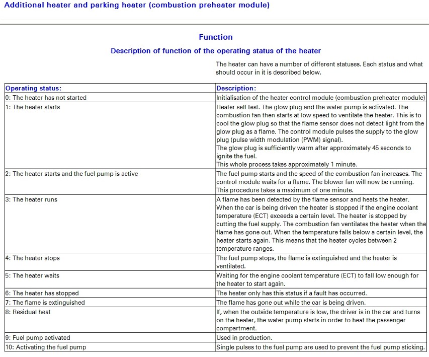

Daca apare ON si nu face nimic inseamna ca are eroare stocata pe CEM de "blower fan " si nu mai porneste ventilatorul.
Sau daca are stocat CEM-5F4F Start attempt. Too many unsuccessful attempts .
